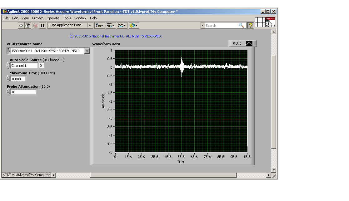

You should now be able to select your VISA resource name.  Then, press the RUN arrow and it should talk to your scope and read the waveform.

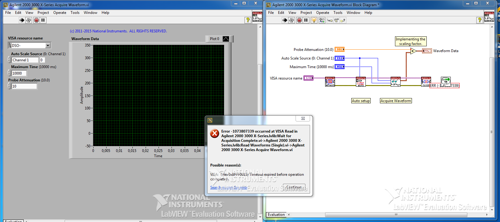

Same ProblemSmiley Frustrated

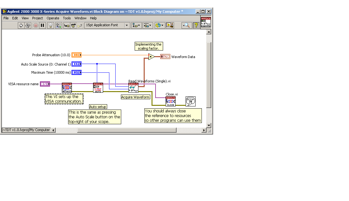

Next step is to open the block diagram of the example to see how it works so you can expand on it if you need.  Generally, when you talk to hardware with LabVIEW you go through the same basic steps.  1) Initialize the hardware and establish communication protocol  2) Configure the hardware so it does what you need  3) Trigger the hardware to collect data [Optional - some hardware just collects all the time]  4) Read the data it collected  5) Close the resource.
I added some extra notes to the example:
What is the name of the example you are running?  Did you select your Scope's VISA name correctly???
EDIT:  Also try turning off your scope and turning it back on to make sure it's not in some error state.

Eror is :3.PNG

@Dennis_Knutson wrote:
It is one of the examples that is throwing the error and an instrument not listed in MAX will cause a completely different error.
Yeah, I got a bit ahead of myself there and didn't read through the thread and look up errors before I typed.  Smiley Embarassed

@prof.Anil wrote:
What is the scope sir ?
The Scope is the oscilloscope you have connected to your computer.  The Agilent DSO-X with all the buttons and knobs. Smiley Wink
Can you expand the VISA control to the right and tell me the whole resource name.  It doesn't look correct.
You're SELECTING it by clicking on the VISA Resource Name control right???  Don't type in the box, click on the control and select from the name(s) that pop-up for you.  It should start with USB0::
EDIT:  You will need to use the finger tool and click the little arrow on the far right of the control.  Get the finger tool by View > Tool Palette   then click the pointing finger.

VISA  resource name is right sir. I change the name from NIMAX. I am sure it is right. Smiley Sad
