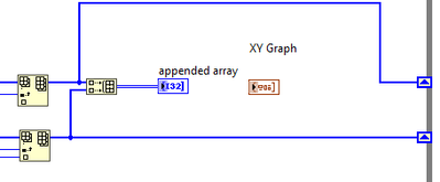

Hi Sir,
Not quite understand, i try to convert the array to the input of XY Graph, but always the wire is broken.

Well, you are not really telling us what you are doing, so we cannot tell what you are doing wrong.
Given two 1D arrays of same length (one for X and one for Y), here are two (of many more!) possibilities.

Well, it works with the 2nd method, but could you still tell me where to find below icon in the first method ?
Thanks.

Bundle  (Cluster, Class & Variant palette)
Thanks.
Numeric >> Complex palette.   Polar to Complex
RE/IM to complex, right?
(Sorry, I thought that's what he already wired up and I thought the bundle code was missing. 🙂
My "first method" described here was the bundle: "Bundle the two arrays or create a complex 1D array. The xy graph accepts both.")

@altenbach wrote:
Yes.  You're right.  Them being on the same palette, I just looked at the name of the wrong one.
I just realized in his message about "the one below", he meant the image below his text in that specific message, but I could see how it could have been read as the image that was at the bottom of the image "below" of your message with both examples.
