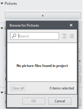

thanks for taking the time to read my post. I've been using NXG for awhile. I'm in the process of making a Power Amplifier validation program. It's gone pretty well so far, but now I want to add some pictures that display the the circuit configuration corresponding to the validation test being done by said program.
I can make an image viewable easy enough with the Image icon found under Decorations and Data Placeholders, however, this doesn't give me any control over said image. The Picture Display icon, also under Decorations and Data Placeholders, seems to be the tool to use, but it's usage alludes me. Apparently you can add pictures to this Picture Display, but when i attempt to do this I get an empty Browser box as shown below. I've tried adding picture files in side the actual LabVIEW project file, but the pictures are still not visible.
I just want an image box whose image varies according to which test is selected, that's it.

Hi Triston,
I believe the step we are missing from our documentation (fix coming soon) is that you must add the pictures to a library inside of your project in order for the pictures to show up as options for the Picture Display.

Hi Triston,
The images in your project need to be organized inside either a Library or Application component.
I apologize, as I recognize that this isn't clear from the dialog or the documentation. I'll work with the R&D team to try to improve this.

Hey Triston,
In order to use the Picture Display, you will need to create a Library within your project, and then add the images to that library(you will need to save the project after creating the library before it will let you add files to the library).
Your pictures should then show up in the Browse for Pictures dialog as you would expect.
