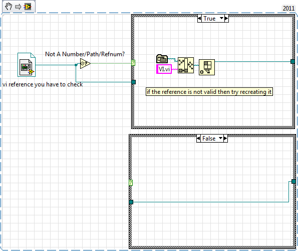

Hi Hugo,
Is the reference stored in an FGV or more generally in a shift register?
Could you eventually share the part of the code generating this error?
One thing you can try to workaround is to reopen the reference if it is not valid. Here is a simple VI to do so:exemple.png

Hi Romain, thanks for your reply.
I will test this way, and leave attached the code that is displaying the error.
