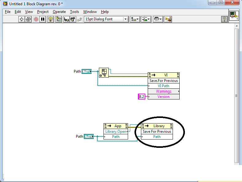

Hello all, I have to programatically downconvert a bunch of VI's from LV 2009 to LV 8.2 , so I am using "Save for Previous" invoke node by getting the VI Server reference of the particular VI (as shown in the figure) . This has to be done for the lvlib also, but by getting the Library reference I cannot able save to the Specified version, it only has got an option to Save for the immediate previous version. Any idea how to save the lvlib from LV 2009 to LV 8.2 programatically ?

That's fine Mike, assume that I have to down convert the Entire folder to LV 8.2 which contains lvlib, lvproj, VI's and controls. I can able to convert all the VI's and controls from LV 09 to LV 8.2 (through that invoke node), but the problem is about converting the Lvlib straight away to LV 8.2. Can you suggest me any solution for downconverting the Lvlib from LV 2009 to LV 8.2 programatically

this would be the solution for downgrading an lvlib an all of the VIs managed in the lib in one step to an oder LabVIEW version.
Define the source path of the lvlib. Define the path where the older lvlib and its items should be stored. And define the LabVIEW version.
This Creates a copy of the lib in an older version with all its items.

Hi Ben,
if you have the password in your password cache it downconverts smoothly.
If you do not have the password and you start the conversation VI then you will
get a promt to type in the password. (see screenshot)
If you do not have the password than you cannot convert it.
Andi
