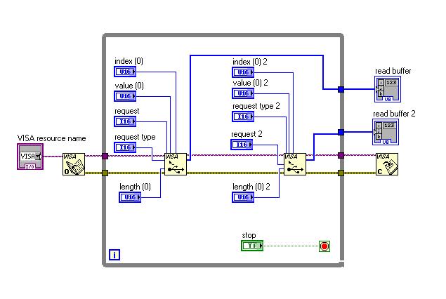

I have attached a screenshot of some example code.  Can you run this example code and return any values?  I will caution you prior to running this code, since I don't have your specific device it might not work.  With regard to your specific device, have you tried running your code on different Windows XP machine?  Is your computer running Windows XP supplying enough power for the USB Raw Device?
I
tried to use the code that you sent me and it would not work for me. For some reason it will not allow me to choose a USB RAW device to run. Any suggestions, I have attached the code I wrote to mimic your below.

With regard to why the example code won't execute.  If you can't see the VISA resource name, you change the VISA control to a constant.  After changing it to a constant you can copy and paste the USB Raw name from MAX (USB0::0x1781::0x0A98::708250::RAW).  This should allow you to see the name in the block diagram and then execute the code.
Corrected your  example code and used it on all computers:
Vista 1: returned data, no errors
Vista 2: no data, no errors
XP 1: no data, no errors
