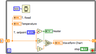

Your VI is a mess: don't (ab)use local variables!

check.png("T. Read" can be deleted when you make the digital display of "Temperature" visible…)

Where do you need to compare those "duty cycles"? There is nothing related in your VI…
