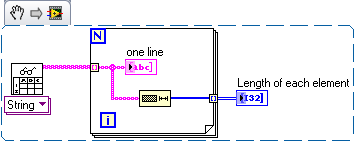

I'm guessing that you want to process one line at a time from the spreadsheet.  Use Read From Spreadsheet File to read in the entire spreadsheet as Dennis says.  Then wire the 2D output to a For Loop with indexing enabled.  Each iteration of the For Loop will allow you to process one line at a time.  When the last line is processed, the For Loop will exit automatically.  Here is an example to get string length of each element in a spreadsheet.
Message Edited by tbob on 03-15-2010 09:46 AM
