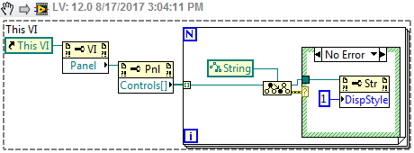

This snippet will turn on codes display for all string controls in a VI.  It will try to cast everything into strings but I just clear the error and move on.
NOTE: I would not run this on your working copy unless you have a backup.  Just sayin'.....

If you are mucking with the display style, make sure to make the display style visible.  Many issues can be quickly figured out with that turned on.
