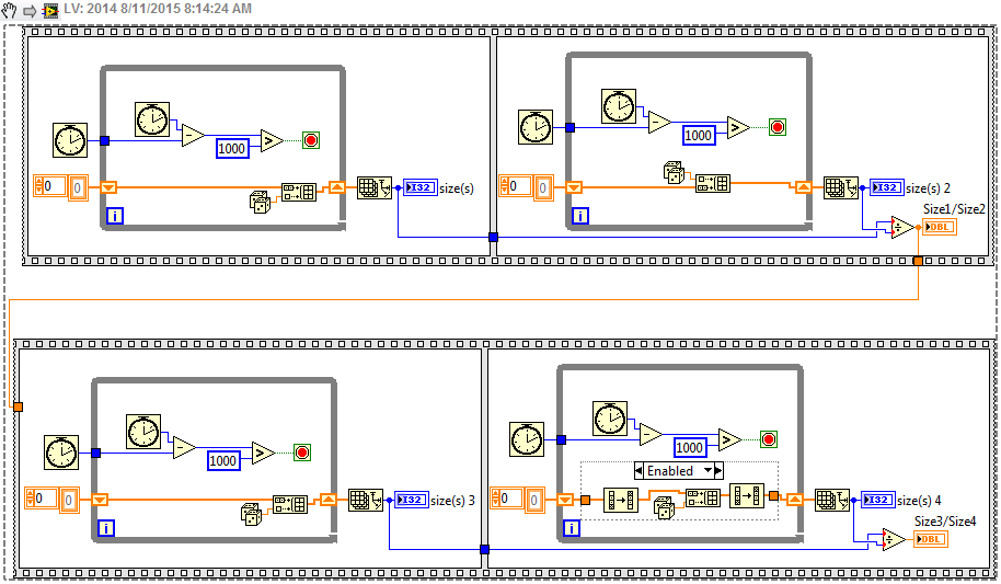

@James.M wrote:
@Hooovahh wrote:
Yeah I've heard it is actually faster to perform a reverse 1D array, add at the end, reverse 1D array again, rather than add at the front.  I personally haven't tested this, and if this were the case I'm not sure why the compiler wouldn't just do it this way behind the scenes.
 Gosh, this whole time I've tried so hard to stay away from the Reverse 1D function because I assumed it had more overhead than just creating the array the right way from the start. I guess I'm reminded again what assuming does.
Edit: It looks like this is not the case... I get 125x iterations with the above code, but with the Reverse 1D Array nodes, it slows down considerably to where the first method is anywhere from 150x to 280x faster.

Oh, I had read Hoover's " I've heard it is actually faster to perform a reverse 1D array, add at the end, reverse 1D array again" as faster at each iteration. Doing it once at beginning and once at the end would obviously be faster, but usually when I'm adding a value at the beginning of the array, it's a one-time thing instead of 100,000 times in a row.

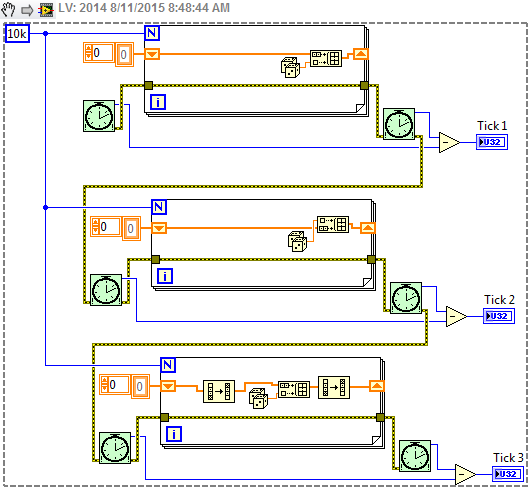

James, don't you want to be comparing adding an element to the start of an array to your reverse array method?  Right now I think you're comparing adding elements to the end of an array to the reverse 1D array method.

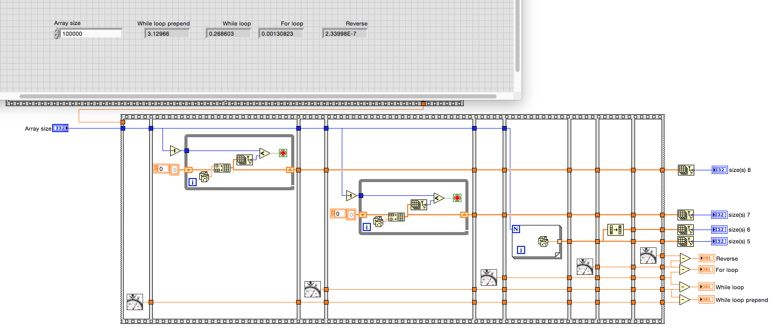

Here is my benchmark. Array size = 100000. While loop prepend = ~3 seconds. While loop append = ~0.3 seconds. For loop = 1.3 milliseconds. Reverse Array = ~35 nanoseconds.
Lynn

Yeah I get your point, and I see your code, it does seem to controdict what I've heard about the reverse 1D array, not sure why.  Someone from NI would need to chime in for an explaination.
