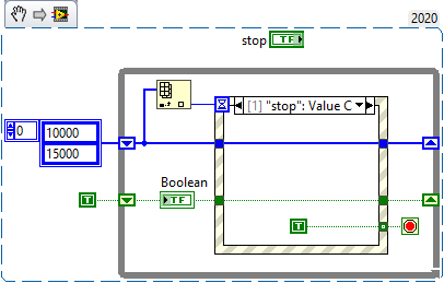

Elapsed timer to start stop the ouput with specified time and stop with while loop
I want to turn on the output for 10s and than off for 15s and run the cycle and want to stop the Vi as soon as i press while loop stop button.
please share the solution by showing block diagram.

There are millions of decent ways to do this...
None involve a global. 😉
You'll make a huge step if you learn about shift registers. And event structures.
Since you want to stop as soon as you press a button, an event structure makes a lot of sense:
