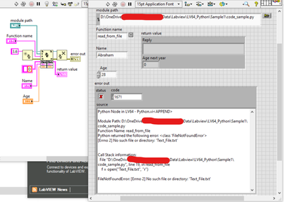

All above are bearable, BUT the biggest problem I see by now:
if your python code has a reference to a file that is NOT full path, code will not run.
The python code is:
def read_from_file(name,age):
f = open("Text_File.txt", "r")
text= f.read()
return text, 120
"Text_file.txt" is located in the same folder as the py code file.
If you change the function to the full path file. it will work! :
f = open("d:\Project\myFiles\Text_File.txt", "r")
text= f.read()
return text, 120
 Since it very common to use python code withe reference to other files (JSON, CSV, INI) that resided in the same folder of the code - I think this is the biggest disadvantage.
