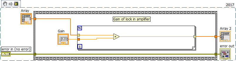

4. Many built-in functions can work directly with arrays, with no need to use loops.  So this:
can be replaced with this:
(Since this entire subVI now consists of a single built-in function, there's really no need for a subVI, just use the built-in Multiply function instead of the subVI.)
