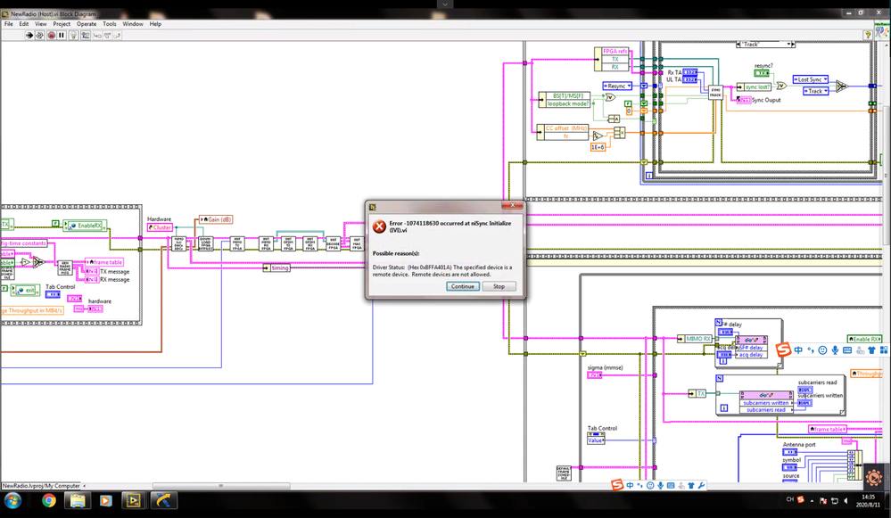

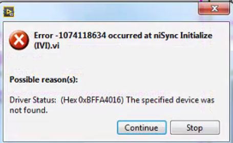

QQ浏览器截图20200812141253.pngWhen I was running the millimeter wave broadband link transmission, I clicked Run after selecting the Transceiver mode, and the program reported an error:
Error -1074118634 occurred at niSync Initialize(IVI).vi
Driver Status: (Hex 0xBFFA4016)The specified device was not found.
I have installed niSync1800.exe before this, but it did not help. Can someone tell me how to solve this problem? I will express my solemn thanks for this.
QQ浏览器截图20200811143531.pngWhen I chose Mobile  Station Transceiver and clicked the "loopback" button,the error occurred.When I chose Mobile Station Transceiver and clicked the "loopback" button,the error occurred.

First of all, thank you very much for your reply. Your reply makes me understand that I need to attach the program code to the post. I will pay attention to it later and thank you again for your suggestions.
The reason for this problem is that the board information in NI MAX does not correspond to the board name in Hardware Configuration in the program. This problem has been resolved. thank you for your reply.
