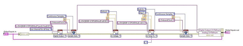

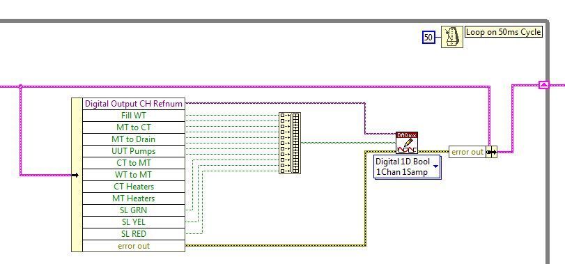

The test control software I am writing requires me to take 21 analog samples (1 sample from 21 unique channels) and write to 11 digital outputs that drive relay coils. I seem to have the inputs working correctly, but when I attempt to write to the output I get error 200621 as shown below:
The loop polling the inputs and writing outputs only executes every 50ms, so I am confused about how I could be possible overwhelming the bandwidth on my cDAQ. Here is where I am setting up the tasks, and where the data is being written:Capture1.JPG
Full code is attached. Any ideas what I'm doing wrong, or what could resolve this? Is there a better method to read/write a single sample per channel per run of the VI loop?

I'd be looking into an option where the DO task uses on-demand software timing (by never calling DAQmx Timing.vi) so that the relay coils change immediately.  Buffered DO will have latency between the time you write to the buffer and the time that those values get generated as signals on the board.
Further tips: in the loop, read your AI data first and *then* do your on-demand DO.  Further, to prevent the possibility of the software loop lagging behind the data acq task, leading to an AI task buffer overflow, use a DAQmx Read property node to query "available samples" from the AI task  before doing the Read.  If 0 or 1 do a normal 1 sample Read.  If > 1, read them all.  You'll need to evaluate what to do with these extra samples in the context of the process you're controlling -- maybe you need to consider the whole history of some channels, maybe you only need to consider the single most recent sample.

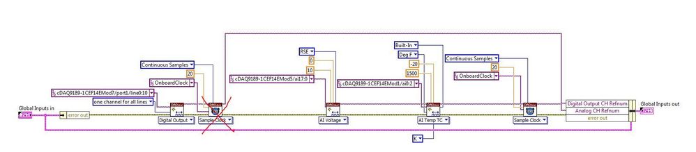

Regarding the second point, removing the DAQmx timing vi seems to have solved the issue. The error no longer occurs.

2. Yep, as expected, no more DO errors when switching from buffered to on-demand.
