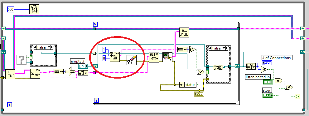

After a quick look, your problem appears to be here:
On the server side, you read an extra byte. The client never sends that byte, though, so all the data that the server reads afterwards is corrupted.

  I uploaded all the subvis. And yes It does read it then it thorws and error, I clear the error and get the data after. there's no corruption in the data as fas as I know.  The additional one that you're  mossing. I just uploaded
Have you understood how this code works? When you send a cluster, you send 4 bytes first, which indicate the length of the data that follows. Except that here, your server reads 1 byte first (which the client never sent), so then when the server tries to read the length, it reads 4 bytes - the last 3 bytes of the length, followed by some random byte from the data after it. That means the length is completely wrong, and as a result, the data is corrupted - it can't be unflattened because it's the wrong number of bytes and even if it were the correct number, everything would be shifted by one byte.

Thanks for the explanation Nathan. I was following an example of a server that in the labview example templates. I will remove the first tcp/ip read so I can read all 4 bytes.
