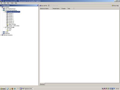

I have tried to reset NI-DAQmx configuration under Measurement and Automation explorer, as suggested on https://www.ni.com/en/support/documentation/supplemental/06/answers-to-frequently-asked-questions-ab... (see Q) NI-DAQmx needs to be reset for this kind of problems.
We used to have a NI-DAQmx task named "NI PXI-4472B modules" under the Data Neighbourhood. After resetting, I wanted to create a new NI-DAQmx. But when I reached the steps after select "create new NI-DAQmx task" - "Analog input" and "Accelerations", I saw a empty panel written "No Supported Device found".
Then following your suggestion, under the "device manager" of windows, I reinstalled that the PCI-1510 cardbus controller. But the problem is not solved. Moreover, I can't find the way to reset my device under "Devices and Interfaces". There is no "reset your device " by right click the device.
(4,209 Views)
also please refer to the attached photo22685iCA5AB31574E23735
(4,206 Views)
