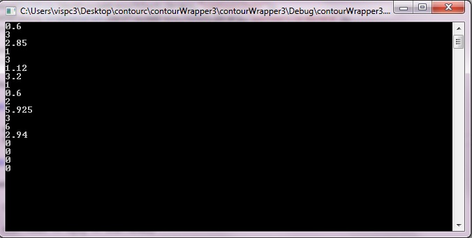

 This is the output window of the above C tester code. It displays the correct output of array.

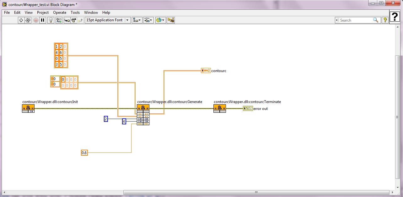

And this is the VI that does not work.

I cannot test it myself because I am still missing DLLs (likely relating MatLab) but there are obvious differences in the wrappers. (at least from what I am seeing).  I admit to being rusty though.
In the VC++ code it looks like you are using 1D arrays.  Simply calling a 1D array "image2DArray" does not make it so.
type name[size1][size2]...[sizeN];
2D arrays would need two sets of brackets no?
While in LabVIEW, supposedly equal code, you are using 2D arrays.
Hope this helps... (and is accurate)

But C++ does not differentiate 1D or multiple D array I think. They are all a pointer pointing to a string of memory locations. So a 2D will be converted to a 1D array, row-based in C.

But LabVIEW does.  The declarations (in C) for different types of arrays are not the same.  I think you are passing extranious data to the DLL which is causing the issue.
I will defer to your expertise however.  Over the years my knowledge in this area has waned.  Perhaps you are correct (in which case I am not sure what is wrong).

I believe your problem is that you are not initializing the output array contourc (or just c in your example C++ code) to a large enough array. In the C++ code, you initalize it to an array the size of image2DArray, but in LabVIEW you initialize it to a single element. Use "Initialize Array" to create an array of the correct size before you pass it to the DLL function.
EDIT: This of course also explains why the output is always a single number rather than a full array.

You are right. After I inited the array to the size of the image2DArray, it returns the entire array.
But still it only runs once. The second time I click 'Run', it returns error 1097. I have to completely shut down LabVIEW and reopen to run it again. I have a feeling it is something about the init/terminate the DLL calling stuff, but I don't really know where.
