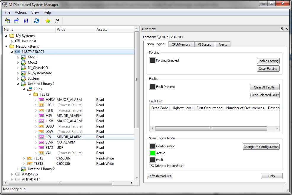

When I try to explore the distributed system manager, I can see :

Ive tried this on 2 different cRIO9074 devices, and 2 different PCs  All I see in the distriduted system manager is "process failure" when i do a caget i get :
