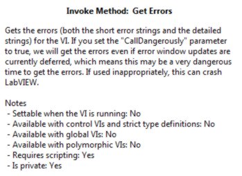

Try adding this to labview.ini:
SuperPrivateScriptingFeatureVisible=True
SuperSecretPrivateSpecialStuff=True
SuperPrivateSpecialStuff=TRUE
Here is an image of the context help:
Context Help
