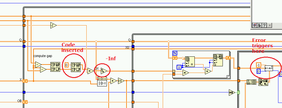

I have found the problem.
This error occurred often in my application. I don't understand the algorithm deployed but I could track the error to figure what is happening.
The problem is triggered inside "Matrix left divisionMM" VI and is caused by a -Inf value in the input matrix. Going back through the code I could find out the inversion where the -Inf was generated. The result of the sum of the gap array and epsilon's squared root was zero and its inversion caused the -Inf. But this made no sense because the gap should be always grater then zero as the initial solution is always inside the range.
The problem happens when any value in the initial solution is equal to the maximum limit. I don't know if this always happens but in some cases the gap created is exactly negative squared root of epsilon. Adding a positive epsilon's square root result in zero. So the problem is caused by a floating point residue.
Adding a zero limit before the add operation seems to solve the problem.
PS.: I have found this problem in Labview 2012 and 2011.
