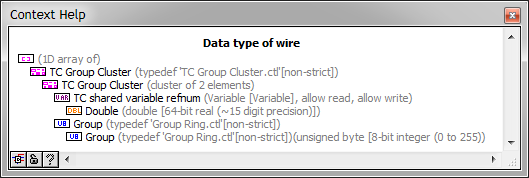

I am taking the array of clusters shown here...
...and passing it through a "To Variant" VI, and then subsequently writing to the shared variable (data type: variant).  Diagnosing the failure of the real-time VI to read data, I found that the shared variable write on the host VI was producing the following error:

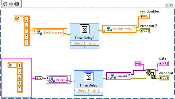

Patrick, what version of LabVIEW are you using?  Here is a snippet where I was able to get both setups that I believe you are describing to work without issue on LabVIEW 2015 SP1.
Message 6 of 8
(6,903 Views)
I'm using LabView 2015 SP1, too.
Maybe it's the type of variant that's causing issues?
I start with an empyt variant and add all my doubles as attributes via "Set Variant Attribute", then attempt to write the resulting variant to the shared variable
Message 7 of 8
(6,894 Views)
I see what you mean.  I was able to reproduce that on my end.  Do you need to create your variant data that way?  If you can do the same thing by using "to Variant" I would just do it that way, because that seems to be working.
