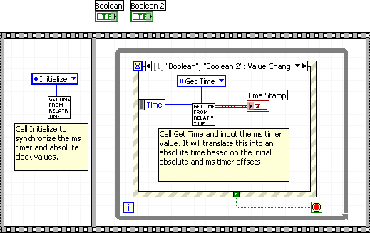

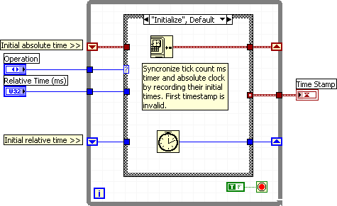

Save the two VIs and open Example Get Time.vi. This uses a functional global (i.e. Action Engine) called Get Time from Relative Time to synchronize the timer ms clock values with an absolute time. After being initialized, it will translate any timer ms value into an absolute time.
Note: The timer ms value is a U32 that will eventually roll over (perhaps every six months or so). Rolling over once will not affect this VI, but rolling over twice will. So make sure to restart the program once a year!

Here are the pics for anyone without LabVIEW 8.2.
