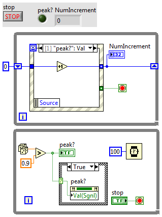

I can't open LV14 either but here is the very simple case structure method.  Whether or not you decide (or need) to use a more advanced architecture like a state machine is irrelevant.  You should still understand the basic structures in LabVIEW.
