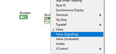

is this what you mean? how do make it say value(signal)?

Right click it and chose change all to write..  Right click it again and chose link to panel and select the Front panel object
Or rightclick the terminal and chose Create Property node

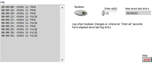

Have a look here for some ideas...
(just remove the parts you don't need, e.g. the logging at some interval even if the boolean did not change. Simply replace the switch with an LED indicator and read the value from your instrument instead)
