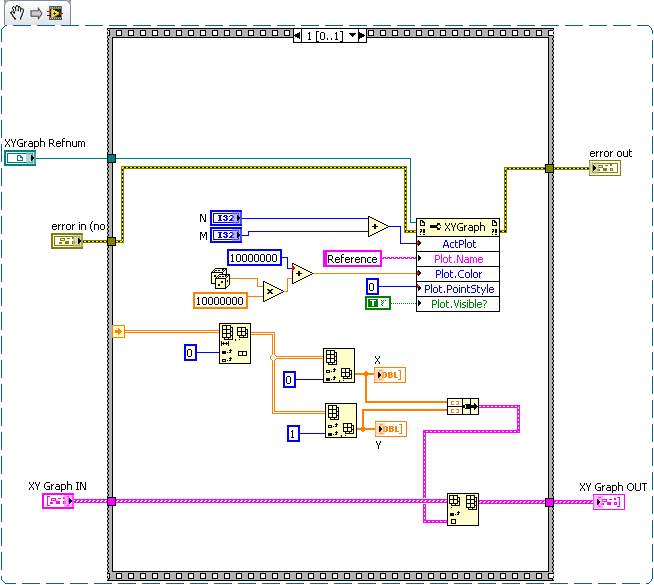

maybe you can explain me the error which happens there :
The error is 1077 (property nodes : invalid property value at arg 3).
I think the problem is plot color. It works, but not every time. Do you know how I could generate random color ? Or maybe random choise between 5 or 6 chosen colors ?

One fundamental mistake you are making is passing a dbl to the color property (arguement 3 as the error message says). The coercion dot is a pretty good clue.
Message 46 of 52
(2,010 Views)
Yes Dennis I know this but I didn't know how to choose a random color by another way. And about coercion dot : i've got one on each property node argument, do you know why ?

Yes, I know why - you are passing data that is not the correct representation. That is always the reason for the coercion dot. Just stick the appropriate conversion function in between or use the correct representation in the first place.

Childish solution but works.
Message 49 of 52
(1,993 Views)
Great solution Dimitrios, thanks 🙂
And Dennis, ok, but it is very demanding, a I32 instead of a I16 would create a coercion dot, but works 🙂
