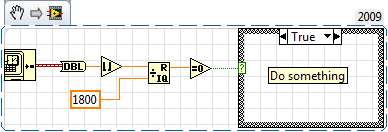

I don't think Ben is referring to user events but rather than a more general event such as some period of time passing.  Ben, since you are using large intervals such as these, you can trigger writes when the system clock converted to seconds is a multiple of 1800 (see below):
20265i9BF41BE4154551E0
Regarding the file output, as I said in my previous reply to a similar post here, I would suggest writing the values directly to a text file in the format you desire.  This will give you the greatest control over your output.
Cheers, Matt

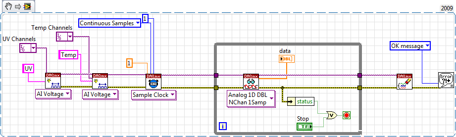

The wait is not necessary.  If you want to execute at a rate of 1 Hz, simply use the DAQmx API explicitly as below:
20279i1EFDFEE65E68CCA6
Here the acquisition rate is set explicitly to 1 Hz and the read will sit and wait until a sample is available at each iteration resulting in a 1 s loop execution time (another option is to use the timed loop with the iteration rate set to 1 Hz).  In the mean time you can be doing things in parallel to this (not necessary in your case unless you add a lot of computations outside of what you put up, but nice none the less).
I think that the reason you are dropping data has to do with how the acquisition proceeds - you have a wait placed on top of any wait that might be expected in the acquisition that you have set up (plus computations and file writing downstream).  Jitter introduced because of the operating system can also make the results non-deterministic (i.e. there is the possibility that you will drop more data down the line).
I didn't execute the VI, but I am willing to bet that the loop iteration rate is a little longer that 1 s which means that you might drop a second here and there and thus only capture 9 values in 10 s (I don't see anything else wrong right off the bat, but I may be missing something).
Anyway, those are just some thoughts.
Cheers, Matt
