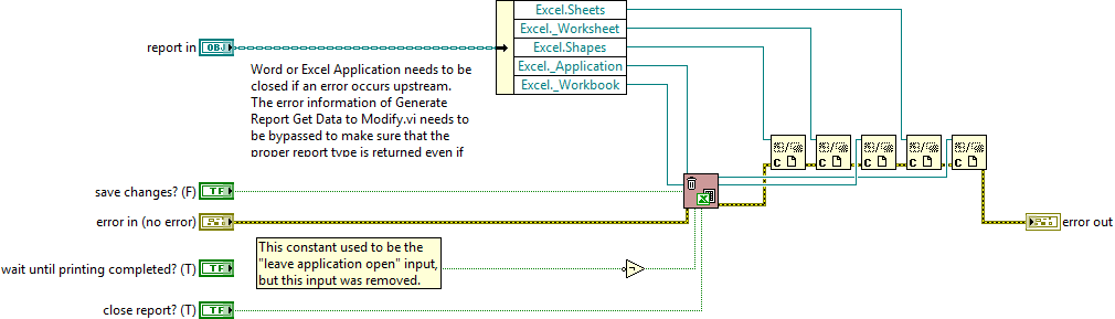

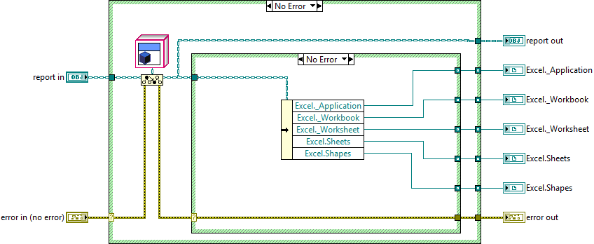

Here's the diagram of Excel Get ActiveX References.vi:
No matter how many times you call this VI, the references returned are always the same. So calling this VI in a loop has no effect on memory, performance, etc.
The reason you aren't supposed to close these references is that they are stored internally to your report reference (as part of the class data), and are used by other VIs in the Report Gen API. Those references need to be kept open until you are done calling Report Gen VIs, at which point you should call Dispose Report.vi as the last VI in your "chain". Dispose Report.vi looks like this (for the Excel implementation):
This is where those references get closed. You should always call Dispose Report.vi to make sure all ActiveX references used by this particular report object are closed. If you don't, then there is the potential for them to be kept in memory by LabVIEW, even if the VI goes idle. LabVIEW is able to auto-dispose some reference types when VIs go idle, but I don't believe ActiveX references are one of those types.

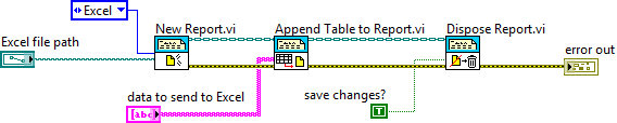

Alternatively, if you have an existing .xlsx file on disk before the code runs, you don't even need the call to Save Report to File.vi... Dispose Report.vi has an input that allows you to save before closing:

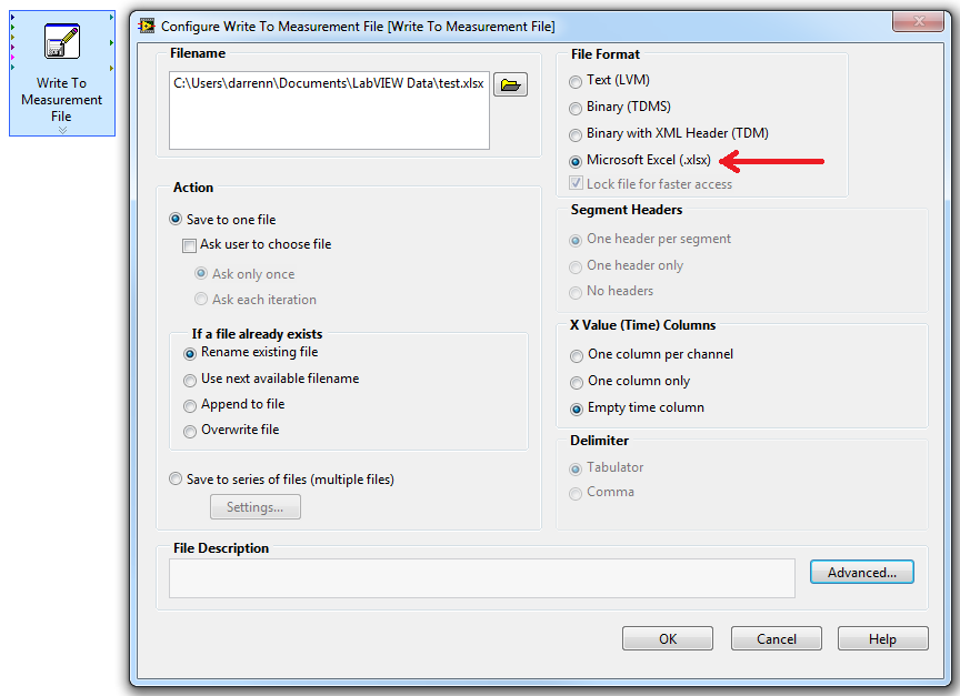

One more thing...if all you're doing is dumping data to an Excel file, and you're in LabVIEW 2013 or later, you don't even need the Report Gen VIs. The Write to Measurement File Express VI has the option to save data to an .xlsx file in LabVIEW 2013 and later:
