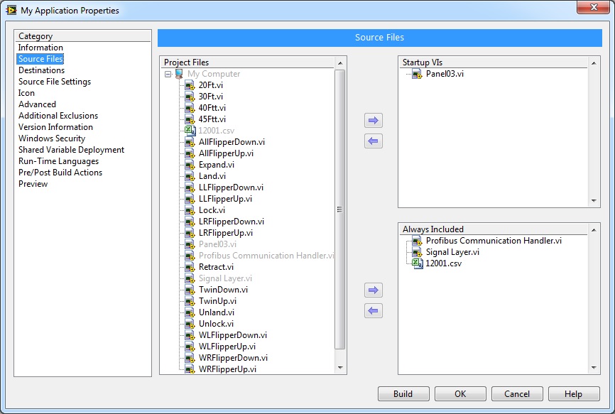

the properties of the EXE file as below.

There are number of files in the project files, why you are not adding these files ?

Hi Ranjeet,
So i should add all files related to the panel03 to always included?
how to make Profibus communication handler.vi & signal layer.vi running all the time?

Yes you should. Here you are telling labview that in real time project I am gonna all these files.

Hi Ranjeet,
after include all files into "Always Included" same problem still occurs.
the Signal Layer.vi is not running when i run the application.

First of all you should NOT include all the files from the project. LabVIEW will by it self find out what .vi files are needed to build the exe when you have selected the start-up .vi file.
The only files that is needed in Alway-include, is files you call by reference.
As your excel file is not a files that can be include in a exe file, that files is placed in the data folder beside the exe.
One question is then, how are you refering to this file ? how are you given the path ?
