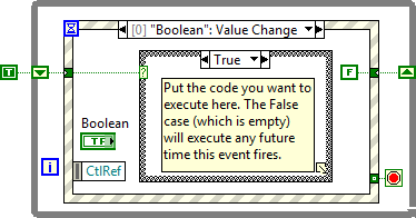

The easiest way to accomplish this is to use a shift register to keep track of whether or not your Value Change code has executed yet. Once it has, set the shift register to FALSE so that the code in the Value Change case doesn't run again:
Note that the boolean wire is passed through all other event cases...this allows other events to fire before the first Value Change.
There are other ways to solve this problem (like dynamically registering and unregistering for the Value Change event), but keeping a state value in a shift register is probably the simplest way to start.
