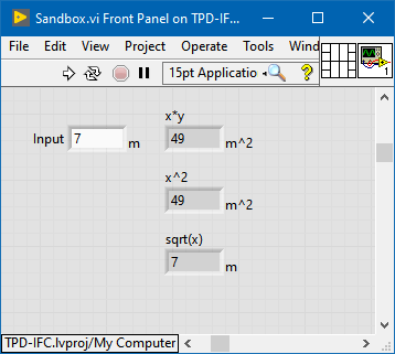

@billko wrote:
If I recall correctly, it has nothing to do with efficiency; rather, there is a peculiar bug in the x^2 function where it doesn't handle numbers with units correctly.
It may not be the reason why it was done this way, but I was right.  And it is a bug.  I don't know if it's been resolved.

@billko wrote:
It appears that they have fixed it:
