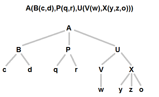

So, for example, a string such as A(B(c,d),P(q,r),U(V(w),X(y,z,o))) has a tree with root node A, and there are three children of A, namely B, P, U, and all of them also represent a tree (sub-tree of the original tree A). So that, B is the root of the sub-tree where c and d are the two nodes. U also has two children that represent individual sub-trees, namely V (with one child) and X (with three children).

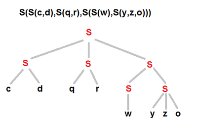

Although, there is one detail, which may actually help the process a bit. The trees are simplified, so that all the nodes that represent some tree (or sub-tree) are just called S.

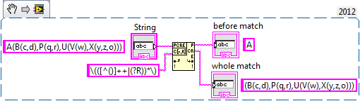

A little RegExercise for the morning:
No time to expound on the limitations of finite state automata, but this limited use can be handled by the recursive capabilities of pcre.  If you start trying to anchor the regex or match more than the portion enclosed in parentheses then you are in trouble and will need something like the .NET regex framework.   Or wuss out and simply use a while loop to count opening and closing parentheses.
