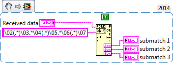

Match Regular Expression.vi is probably the best choice in this case. You can then use Write To Spreadsheet File.vi to write to a .csv text file that can be open by Excel.
Ben64

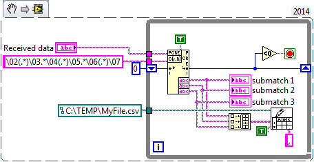

You have to loop until the end of the string to find all matches.
Ben64

I did try that. I even tried giving a feedback loop from past offset to offset, but it just began blinking all the values. Also,why isn't it writing to a CSV file? I coonnected it the same way as you've. The spreadsheet stays blank. Smiley Sad

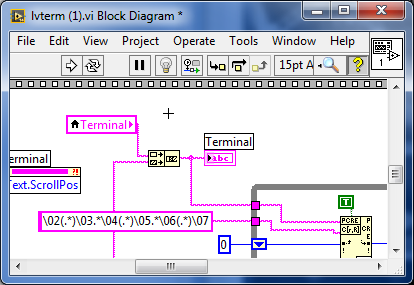

One thing you can try:
1- right-click on the string constant \02(.*)\03.*\04(.*)\05.*\06(.*)\07
2- select '\' Codes Display. The string should now appear as \\02(.*)\\03.*\\04(.*)\\05.*\\06(.*)\\07
3- Still in Codes Display modify it to  \02(.*)\03.*\04(.*)\05.*\06(.*)\07
Ben64
Message 7 of 11
(5,159 Views)
Almost done! Now it's writing to the spreadsheet continuously rather than writing the data just once.
