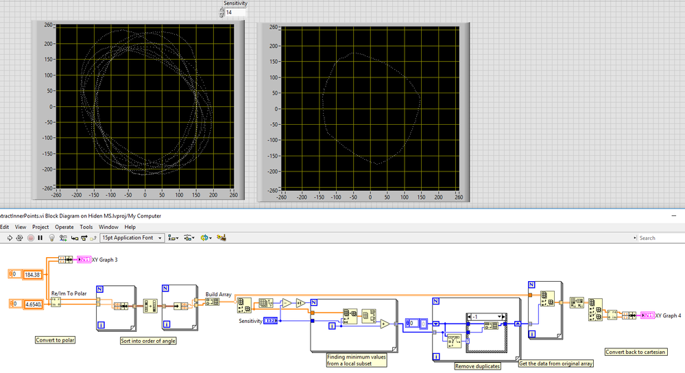

I have attempted this with your data.
Adjusting the Sensitivity gives fewer or more points, for your data a sensitivity of 14 gave the optimum result. It would scale with how many "loops" your data has, I suggest using double the number of loops.
File attached.
I noticed you used LV2012, so have not utilised the sort 2D array function from LV2017 (or the OpenG one, for ease of sharing)
There may be easier ways which I have missed, and this may be able to be optimised (I've assumed the dataset is small), but this one gives a fairly good set of "inner" XY coordinates. You mentioned you could do the rest.
Let me know if it works for you.

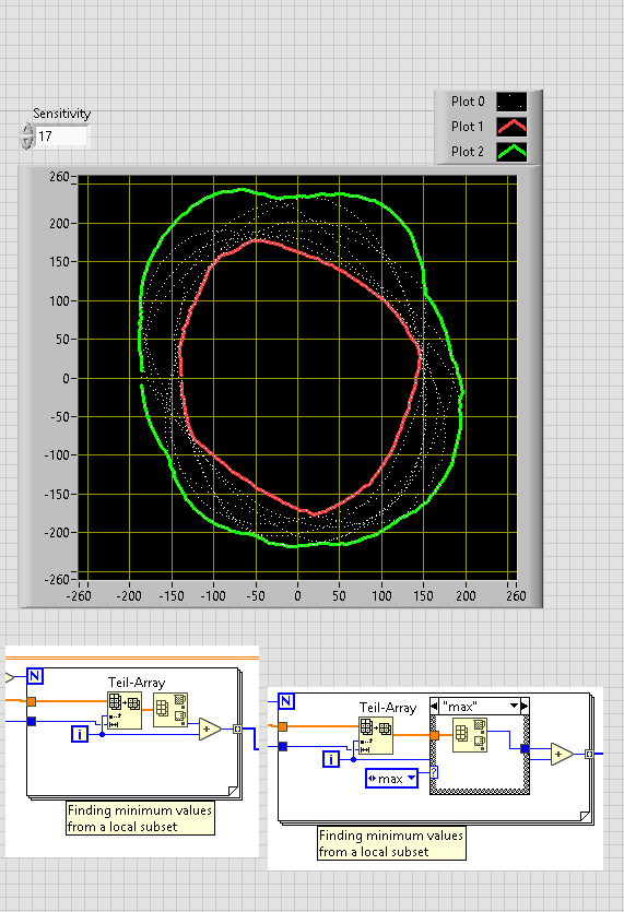

Ed. This is basically the same first step as IanSh proposed above.

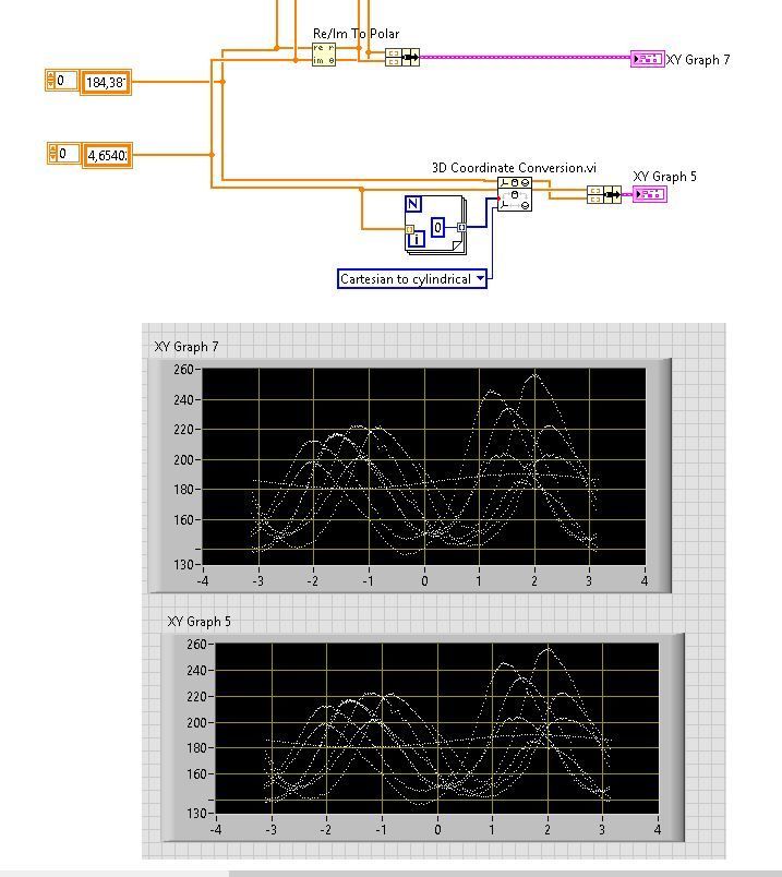

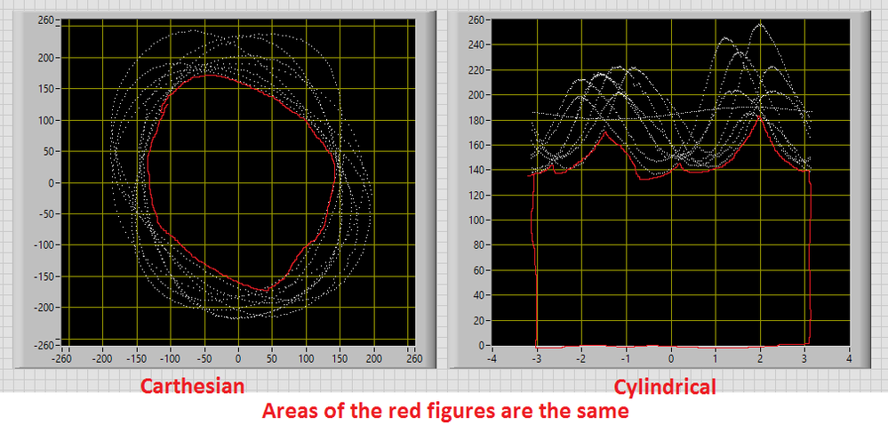

Not a solution, but a tip: try converting carthesian coordinates to cylindrical. Then calculate the area under the points clouds, which might be easier:

Thanks for quick and accurate answer.
I tried this method on several datasets, all works fine!
Best regards!

@alexderjuengere wrote:
I'm just interested, why would this be easier:
"try converting carthesian coordinates to cylindrical. Then calculate the area under the points clouds, which might be easier:"
As in IanSh solution - you need to find minimum "edge" of the points cloud and then integrate (sum) area under this edge. I can't exactly find the direct way to calculate this area in original (carthesian) representation, but I can think about a few ways to do it in polar* coordinates.
*I've used conversion from carthesian to polar with Z values = 0. This is the same as converting Re/Im To Polar - I just didn't yet read enough altenbachs posts to immediately think about 2D planes with complex numbers ;D

It will be quite important (I expect) to make sure the sensitivity is set correctly, as a single outlying point may throw your answer off a bit.
Indeed, I like that your implementation with "3d coordinate conversion.vi" can be easily extend to a 3d space
