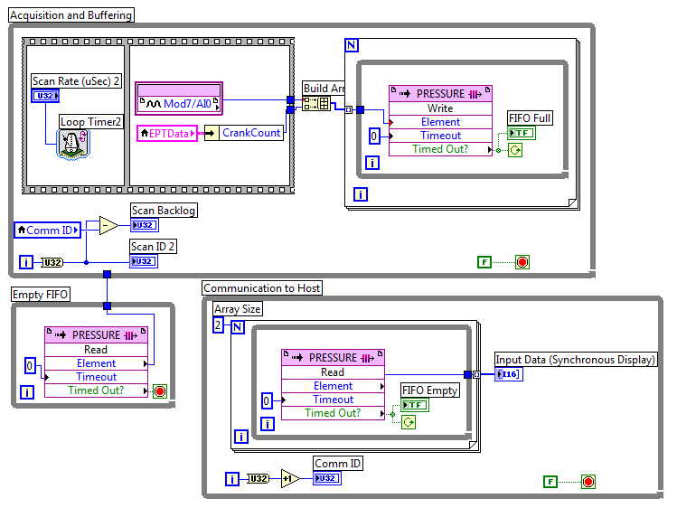

I have a 360 count encoder and a pressure transducer, I'm collecting position and pressure together (this is attached to an engine so my values for the encoder will be from 0 to 719) because the pressure-at-position is very important for all of the calculations I will be doing. I used this tutorial [link removed; article no longer available] to develop my FPGA and RT block diagram. Here's my FPGA:
And here's how I'm currently monitoring the FIFO output in my RT:

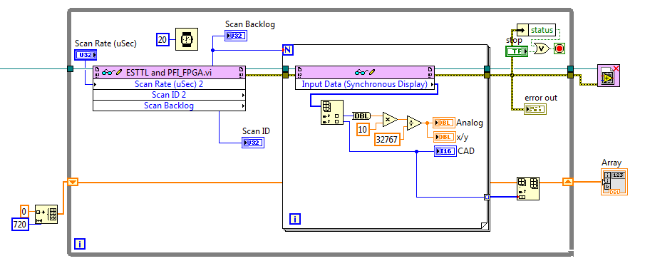

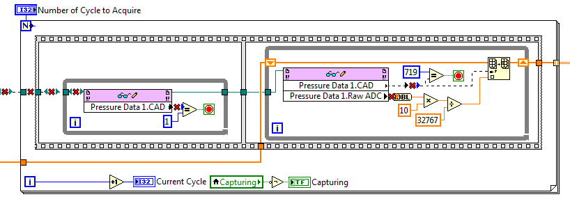

Here's how I used to process this data before using the FIFO:
(sorry for the broken lines, I took this section out before taking a screen shot)
The old method is fairly simple:
  1. Sync with TDC (0 Crank Angle Degrees, (CAD))
  2. Insert values in to array until reaching 719 CAD
  3. Repeat for desired number of cycles (Number of Cycles to Acquire)
Now there are a number of problems with this that I know of, the important ones being:
  1. It could miss CAD 719 and wrap back around
  2. The FPGA-to-RT communication can be too slow and I end up missing CAD (which I can observe - there are spikes where the data is missing and I've initialized the array to use the value 100 so I can pick them out because the regular values are between -1.5V and 0.5V)
Now, I want to accomplish this same thing with the FIFO but am not sure how. I need to acquire 720 samples in a row starting with 0 CAD (so I know all of the analog samples are from the same cycle). Any ideas?

How fast is the data acquisition on the FPGA running? Depending on the rate it might not be possible to transfer all samples to the host.
With your current architecture this will not work. You always have the latest values on the "Input Data" indicator, there's no buffering or anything. So when you access the indicator from the host you will just get a snapshot, but you will most likely miss samples. During the 20ms wait in the outer loop you probably write hundreds of values to the indicator, but you will only get the last of these values.
You might want to use a FIFO between FPGA and host to send the data buffered.
Message 2 of 38

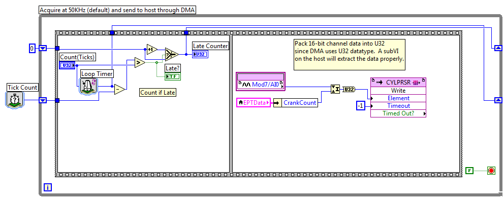

Thanks for the tip, I've updated my FIFO code to use the DMA FIFO configuration. My FPGA now looks like:

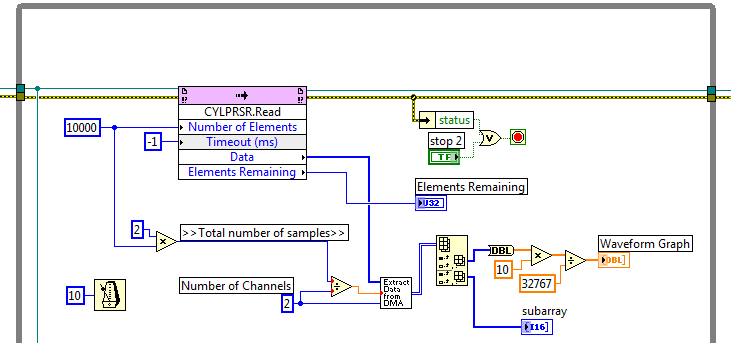

And my RT:
However, this code is similar to my last in that it just displays the data rather than doing anything useful with it. I'm still not sure how I'm going to assemble the data in to sample sub-arrays storing the pressure data with indices 0 to 719. Any ideas?

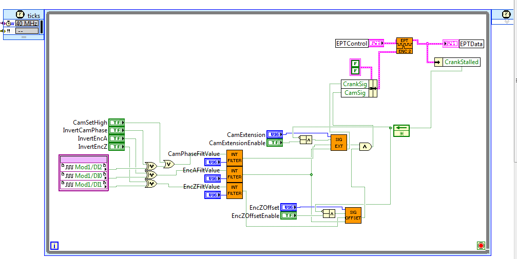

On a side note, this code is also in the FPGA:
Which is what generates the CrankCount variable. Whenever I choose a value around 1000 or higher for Count(Ticks) the data for CrankCount becomes unstable, often producing 0s.
Also, my data appears to run backwards (instead of the CrankCount values going 0->720 they go 720->0) whenever my RPM goes below 600, not sure what that's about but assume it has something to do with the communication speed between the FPGA and RT device, the amount of data and I'm reading the the Count(Ticks).
Message 5 of 38
(5,489 Views)
The 600 RPM actually makes perfect sense - I'm collecting samples at 50 kHz, at 600 RPM 360 degrees is 5000 samples so one full cycle (720 degrees) is 10000 samples exactly. So, when I drop below 600 rpm my data is coming in slower than I'm reading it.
I'm still not sure why when I exceed 1000 Count(Ticks) the single-cycle timed loop has issues.
