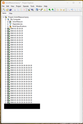

I have discovered what the issue was:
My .lvproj seemingly had too many cRIO targets associated with it.
In more detail, I have created two FPGA .VIs which support a multitude of different cRIOs, FPGAs, and C series cards.
You can see below the different configurations which I have in my project:
(I have blocked out the ones with IP addresses listed, the rest are "dummy" targets which I compile bitfiles for.)
Because LABVIEW doesn't support dynamically changing the cRIO and C series cards (I hope this changes), I have to manually add all targets and the unique configuration of cards that will be used with my program and compile them (I have a VI which allows mass compilation of bitfiles, thankfully.)
Recently, I went to add another configuration: 9040-9269-9252-9252-9252-9252-9252-9252-9252
The addition of this target seemingly pushed my project over the edge.
I noticed this by watching my RAM consumption when loading my project: The entire project and all cRIO targets, cards, etc. get loaded into RAM when the project is opened, however, at a certain point, my RAM consumption would no longer increase, yet, things were still "loading". (Because I am coding for cRIOs, I use 32-bit LABVIEW to make the bitfiles [ultimately I compile my Windows executable in 64-bit LABVIEW], and my project with this new target was hitting the RAM limit of 2 GB for 32-bit LABVIEW).
So, upon deleting this new configuration from my project and attempting FPGA compiling, everything works fine.
HOWEVER, I am left with the problem that I cannot add this new target which I need to compile my bitfiles for.
Apparently, NI is bringing cRIO FPGA programming to 64-bit LABVIEW, but, it isn't released yet.
Until it is, I am left with this limiation with only annoying workarounds (multiple projects).
