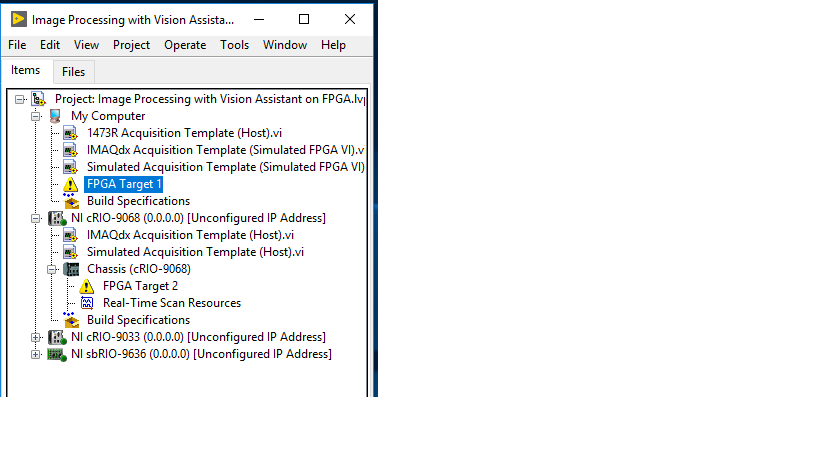

I try to open example project from Labview 2018. But, I get warning for the Fpga Target as shown below:error.png

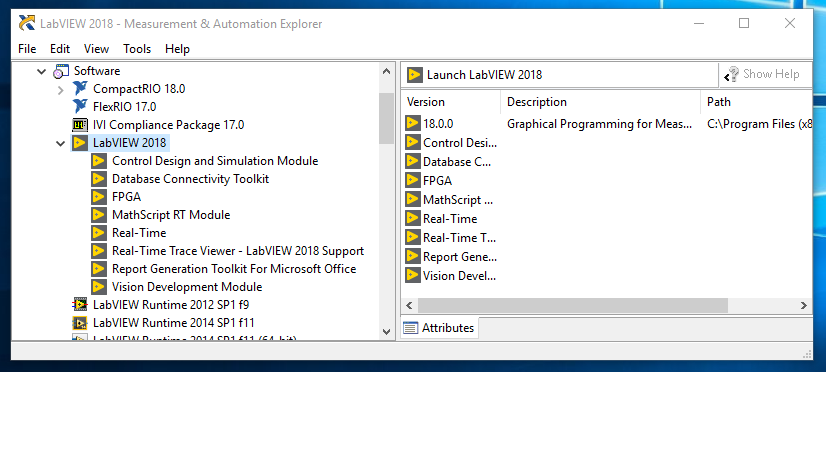

I have install the FPGA and real time module. I use Labview 2018 (32-bits). Below is the details from MAX.error1.png
I also have install the NI-RIO driver. Why I get that warning?

I try to open example project from Labview 2018. But, I get warning for the fpga target:
 error.pngI have install FPGA, real time and NI-RIO driver modules as shown in my MAX:
error1.pngWhy I get the warning and cannot open the Vi? Thank You

From your screenshots, it looks like you have CompactRIO working successfully. The target that is missing seems to be under 'My Computer' in the hierarchy. What kind of target is that? Based on the name of your project, is it one of the Vision RIO devices, like the 1473R? If so, make sure you have NI-IMAQ I/O driver software installed. It could also be an RSeries device, so make sure you have the RSeries driver installed.
From your pictures, it looks like you only have cRIO and FlexRIO installed.

Thanks for your advise. I repair the Labview FPGA at my computer (under control panel) and its work now.
