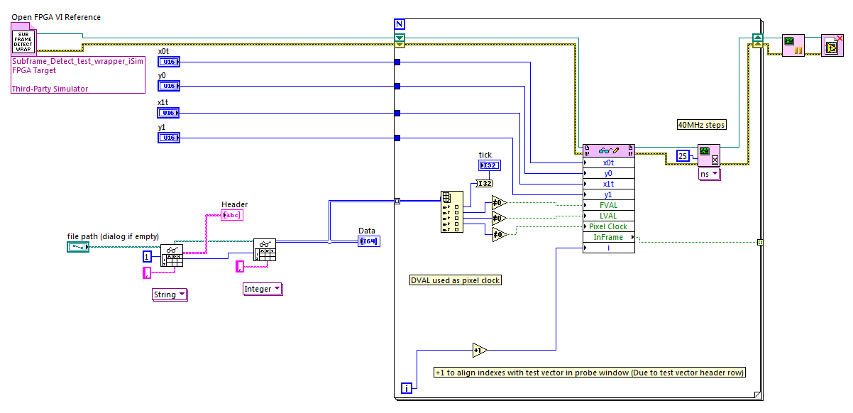

I am using LabView 2014 with Questa/ModelSim for cycle accurate co-simulation.  One thing that eludes me is how to get the host VI to supply stimulous to the FPGA code in a synchronized manner.
For example, if I have a SCTL enclosed FPGA logic function (Subframe_Detect_test_wrapper), I would like to feed test vectors to that in-sync  with the FPGA clock or with defined arbitrary timing.
When I use the niFpgaWaitForSimulatedTimeNs.vi to pace the stimulous in the host vi (After reading a set of test vectors from a CSV file), the vectors are applied once for every 56 (Why 56?) FPGA clocks when the wait is set to 25ns and the FPGA clock is 40MHz.
There's really no examples I've found which directly talk about how to get host VIs to drive aribitrary or clock synchronized stimuli into co-simulated FPGA simulation builds so I'm hoping someone here knows what the magic is.

Hello xl600,
Have you tried placing a Pause between the left shift register and the read/write control?
This should pause the elapse of time, write the values, progress 25ns, pause, and repeat.

Yes.  That doesn't actually work.  There's some sort of arbitration logic that is executing inside the model.  I noticed that the host input data is actually synchronous but they aren't applied to the internals of the FPGA at the same time.  The arbitration process only operates on a single control input at a time.  A pause just tells ModelSim to pause but doesn't affect the control write process at all (Other than delaying during the pause period).
I'm beginning to suspect this is an intentional behavior and how compiled FPGA controls and indicators actually work in real life.  Do you think that might be the case?
What I'm trying to simulate are things like CLIP I/O and intra-FPGA I/O to/from sub-vis inside a SCTL.  It doesn't appear that cosimulation is capable of exercising that level of I/O.
