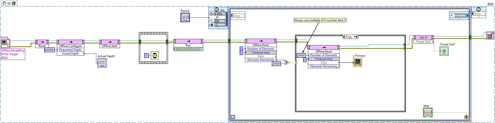

You are using delay of 10msec for every loop in host vi  instead of using a timed loop!
 In Fifo.Configure, requested depth is the Host buffer size and when you create FIFO on Target side the number given for requested number of elements is Host buffer size ( for more info ).
As you are using 25us loop time, to collect 400 samples on Target side will take 0.1 sec. And if your target buffer size is 1024 or sth,to fill it will take some more time,this along with 10msec delay on Host side is may be causing the problem .
With my little experience, I suggest you to use timeout as 0 everywhere to avoid overflows or underflows.(for more info  refer this.)
I personally find this below code is most successful. TRy to use sth like this .
All the best 🙂

Hey,
Glad I could be of some help 🙂
As you are putting delay, it will delay the loop execution by 10msec for each iteration of the loop, instead you have to use a timed loop where your loop time should be 10msec or the time required for acquisition of 400 samples, whatever is your requirement.
