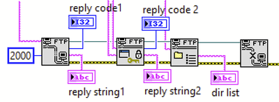

but this simple LabVIEW code fails to list the directory:

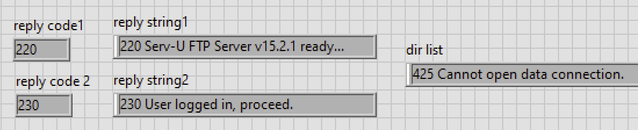

it hangs at directory listing for one minute despite I set timeout to 2 seconds earlier, the error message is:
Error 425 occurred at 425 Cannot open data connection.
NI_FTP.lvlib:FTP Open Data Connection.vi:4490001->NI_FTP.lvlib:FTP Data Receive.vi:3680001->NI_FTP.lvlib:FTP [LIST].vi:1520001->NI_FTP.lvlib:FTP Directory Listing.vi:240001->FW update.vi->

just confirmed the bug: when I'm connecting to FTP from the office I can list the folder, but when I'm in the office and switch to WiFi hotspot from my smartphone I'm unable to list it despite it works in WinSCP. Funny thing is that even VPN doesn't help
