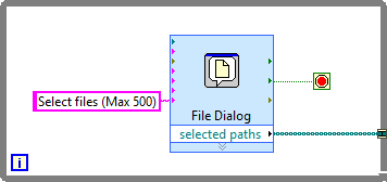

It would look something like this:
... though in my opinion that is a very cumbersome approach for the end user.  Repeatedly selecting files, being expected to remember which of the thousands of available files they've already selected, and then hitting "Cancel" when they're done selecting.
For me a better approach would be what Taki1999 suggested earlier in the thread:  Have all of the desired files in a single folder and then just have the user select the folder to load.  Or, if you wanted a subset, call "list folder" and do some filtering on file names.
Other options would be to select a folder and date/time ranges, or select folder and file type, etc.
