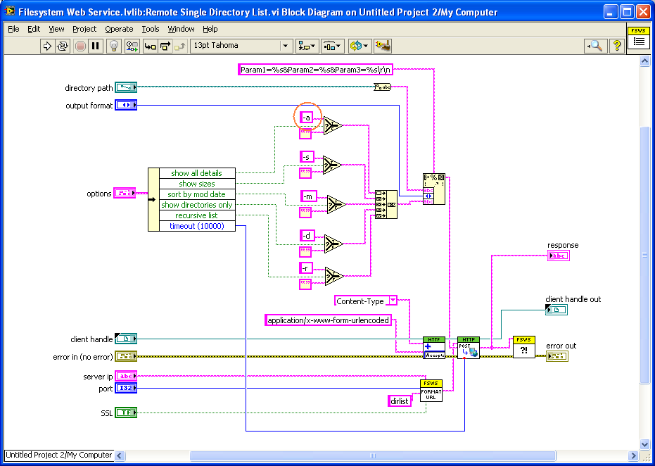

Never mind. I found the problem.  The "Remote Single Directory List.vi" included as part of the API example has a small bug in it.
The "-a" constant circled below in orange should really be "-a " (there needs to be a trailing space after the "a"). You can sort of see it behind the other constants.
After adding the missing space and re-running the VI, I can get this information from the remote directory:
