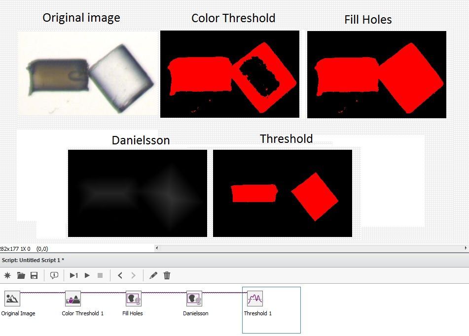

I got very simple algorithm for finding object on picture if that objects are stick together. In Vision assistant this working very well. I have problem when I try to implement this on FPGA. FPGA do not have function Advanced morphology so don't have function like Fill Holes and Danielsson.
My algorithm:
Algoritem.jpgHas maybe someone find solution how to implement Fill Holes and Danielsson on FPGA. Or maybe how to solve my problem on different way and algorithm must be suitable for FPGA.
Thank you for any solutions.
Best regards.

           You are right, you might not find the same function as in VBAI with Vision Assistant under Windows, but I think you can already go for a different implementation using FPGA specific functions.
          To help you speed up the development, I would recommend for you to check the available functions with the Vision FPGA, find the equivalent ones in Vision Assistant under Windows, build the algorithm (first, still under Windows) then move it to the FPGA.

I will try to solve my problem with Basic morphology functions on FPGA. Advance morphology functions will solve this problem more easy, but counts only solution.
