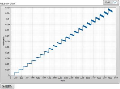

With respect to your comment, that's is indeed the case. The absorption is mainly driven by concentration (which can be seen as the large steps in amplitude below). Between each step you can see the general trend resulting from increasing the pressure (increased abs.) and incrementing the temperature (lowers abs.). Were a finer step choice used for the concentrations, there would be multiple possible matches for absorption regions (in addition to the overlap trend already seen at higher concentrations) - something that has been complicating the envisioned look up process and that I'm not sure how to best handle.

I'm interested, but I'm certain there are plenty of folks with better background & insight about this kind of thing.  So I only have some crude & rudimentary initial thoughts, but I'll offer them up in the meantime until better suggestions come along.
1.  The *use* of this LUT is to take 3 measured values (pressure, temperature, absorption) & use them to estimate concentration.
1.1. there may be some uncertainty in your measured values that you should try to account for.  You may need to consider a wider range of combos around your measured value.  This complicates things.
1.2. but you also have the great advantage of knowing a theoretical relationship you can use to guide your algorithm.
    Looking at that graph, it appears that a given absorption will imply no more than 2 possible concentrations (possibly increasing to 3 if your absorption uncertainty is large enough) to consider from the LUT.  It'll either be near the high end of temperature at the higher concentration or the low end of temperature at the lower concentration (and possibly mid-mid if you had 3 concentrations to consider).  So now your measured temperature can probably tell you which of the LUT concentrations is most likely the nearest one.  That quickly narrow things down quite a bit.
From there you can further use knowledge to consider the extremes: 1st suppose that your measurement uncertainties combine in the particular way that gives you the lowest estimated concentration.  Then suppose the opposite.    This leads you to high and low bounds for the estimated concentration.
But *all* of this work begs the question: why not just use algebra?  Whatever formula you use to generate the LUT, why not use algebra to solve for concentration as a function of pressure, temperature, and absorption?  Then you can just plug your measured values (and perhaps also their values at the uncertainty extremes) into the equation to calculate concentration.
