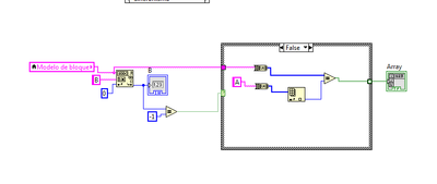

In the program I have done, in the "Sincronismo" case I want to see if the "Modelo de bloque" has the character "B" and show this with a boolean. In my case the "Modelo de bloque" is an indicator, maybe because of that I canĀ“t use in the "Match Pattern Function". So how can I do it for my program?

I will give you two options, with the first being my preference.
1. Store the string value in a shift register.
2. User a Local Variable to read your indicator value.

What is the data the you are going to have to evaluate? Is it going to be the same every time? It will be tough to look for the letter B with out finding B in other data that you may receive. Can you give examples of the different expected responses so the we can better help you find a good solution to your problem?

Use a local variable: right click on the terminal of "Modelo de bloque" and choose Create->Local Variable.
The local will be created in write mode. Right click on the variable and select "Change to Read".
Beware: use local variables only when really needed; never where you can use a regular wire.
More information on local variables in the LabVIEW help and tutorials.

I am going to receive different strings in "Modelo de bloque", for example: 111222AAABBB, ABABABAB112222, AAAB111111AAB... also I can receive strings without the letter "B", for example, 22221111112222

I have tryed to do a program where I find the character "A" in one string and when it finds the first "A" I want to turn on the button of the array that corresponds.
I have done this program but it turns on all the "A" of the string and I want to turn on only the first A found in the string.

Hi 99,
until now you were looking for letter "B", now you are looking for an "A"?
What's the big difference so you need to start a new thread?
When you only want to find the first occurance of a letter in a string then you should not compare all chars but Search1DArray to find it…
