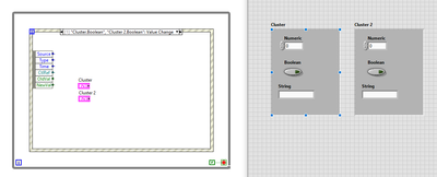

I'm not sure if I can state this clearly, but will try my best.
Assume I have some clusters (in same type def.) containing several elements. In this scenario, I create an event case and set a event that can be triggered when one of the boolean from the cluster is pressed. Is there any way to know which cluster is the pressed boolean belongs to? Please refer to the picture for a sample.

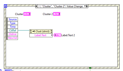

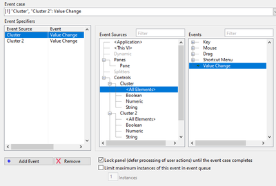

If you use the Event "CLUSTER - ALL EMENTS" instead of Cluster.Boolean
Then the Property Laber.Text from the CtrlRef will return the Cluster Label, and you will know witch cluster the boolean came from .
