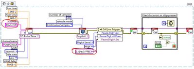

2. For the Finite retriggerable pulse, I want to use something similar to the example code in the article you shared:
But I am not sure I fully understand how this works (see circled in red), especailly the pause trigger. Based on my configuration of counters described above, I am not sure which counter I must connect to the CO Pulse Ticks VI in my case - I am guessing CTR 3 as thats what I want to have a finite pulse train to use as a trigger for CTR1, CTR2.
And as for the pause trigger, I really don't know what I should connect here in my case. Based on my configuration, could you please recommend how I set this up?

Short answer: in your second scenario, use counter 4,5,6, or 7 instead of counter 3.  The problem is that a finite pulsetrain on a 6602 requires the implicit use of a "paired counter".  The pairs are: (0,1), (2,3), (4,5), (6,7).  The error arises because you have two tasks that both need to reserve use of Ctr2.  Once you use one of the higher-numbered counters, its pair will be available and you won't get that error.  This situation was described in Case 3 from cdaug's first link.
The second link won't be needed.  The essence of the idea is to use an external signal to serve the same purpose that the paired counter otherwise would have.  But you'd also need that external signal to have very precise timing properties for the frequency & # of pulses you want to generate.  It'll be simpler for you to just use Ctr 4 (and its pair, Ctr5) for your finite pulse train.
