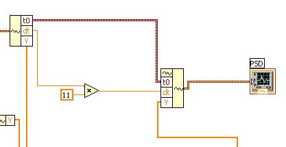

Thank you for your reply. Now I am getting the 330Hz frequency using this code. I have attached the LabView code. But I am not able to divide the x-scale value by number of blades i.e 11.  I can do this by multiplying the x-scale value. Is there any other way to do this?

To change the timebase for your signal, you can get the waveform component dt, and divide it by the number of blades you are counting. Here is an example of what I'm talking about:
Let me know if this work as expected.
