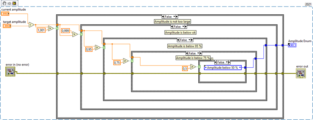

@pincpanter Its not that I can't solve the problem - but its horrible to read, maintain or extend. Right now I have a sub-vi like this:
I will look into Threshold 1D Array mapping.

Unless you expect to receive exactly 1.05 (but why bother about it?), crossrulz already gave you the solution.
If your enum already exists, create an array constant with ordered cases (far too small, too small, etc.) and use crossrulz's code output as an index to pick the right constant.
Looks like great code (for an Aztec)  But, they also used slave labor to build and maintain their pyramids.
Use the threshold method.
