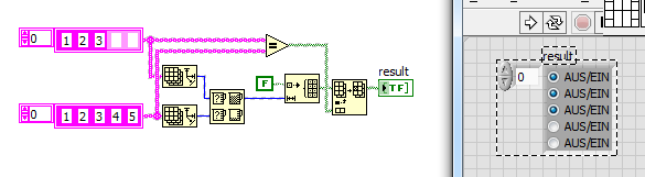

Hi Padmanaban,
without ANY loop:
Other option, also loopless:
(5,144 Views)

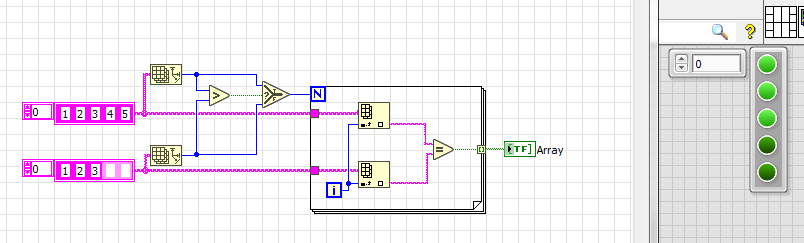

At first I thought this was a silly question, because why would you want to work on arrays element by element that are not the same size? There is one case when I do this though. When I need to put a cluster on a queue there is often a string containing a command and a variant containing data if necessary. To send multiple messages right after another, my SubVI takes an array of strings and array of variants, but not every command requires the variant data. Maybe I send 3 commands but only the 1st uses the variant.
In this case, I set the array of variants to have a normal, non-indexing tunnel, and put index array with the i (iteration) input as the index inside the loop. In this example, i=0 will have an associated element, but i=1,2 will return the default for that array type, an empty variant, which is desired in this case.
(5,089 Views)
Accepted by topic author PadmanabanJ
Or you could use the for loop
Yeah, I know... But I just thought I would show how you could do it with the for loop and unknown array sizes. 😛
Instead of the Greater and Select, just use the Max & Min node.  I find it easier to understand than the two nodes together.
